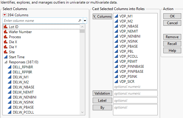

4. Select columns VDP_M1 through VDP_SICR and click Y, Columns. There should be 14 columns selected.
Figure 21.2 Explore Outliers Launch Window

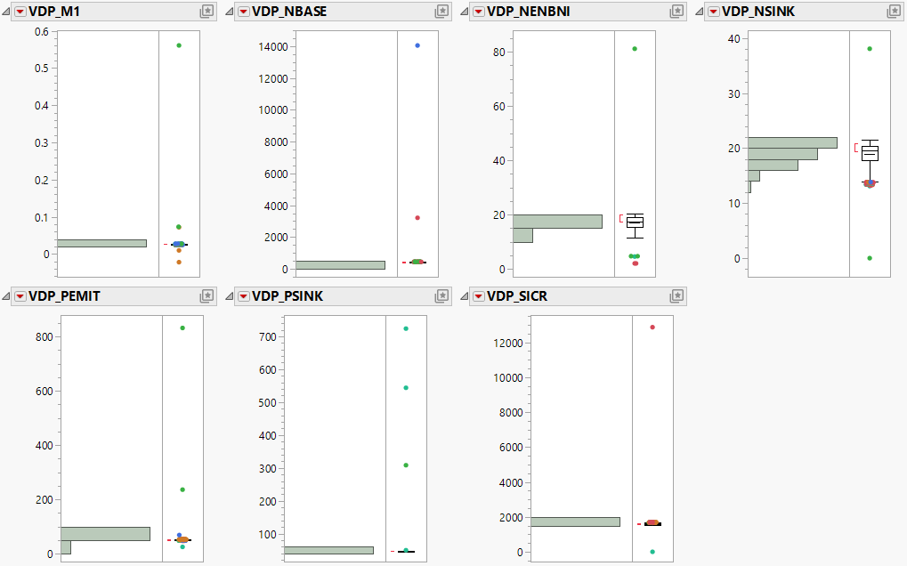

3. Select Analyze > Distribution.
4. Assign the selected columns to the Y, Columns role. Because you selected these column names in the Quantile Range Outliers report, they are already selected in the Distribution launch window. Simply click Y, Columns.
5. Click OK.
Figure 21.3 Distribution of Columns with Outliers Selected
In columns VDP_M1 and VDP_PEMIT, notice that some of the selected outliers are somewhat close to the majority of data. For the rest of the columns, the selected outliers appear distant from the majority of data. Now that you have investigated the data points, you can decide which columns to exclude from your analyses.

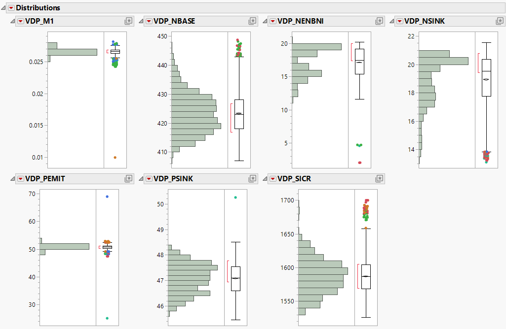

1. Examine the Distributions report again. Notice the selected outliers are now separate enough from the majority of the data to select and exclude them from your analyses.
2. In the Quantile Range Outliers report, click Exclude Rows.
3. In the Distributions report, click the Distributions red triangle and select Redo > Redo Analysis.
Figure 21.4 Distributions of Columns with Outliers Excluded
The displays of the distributions of the data are now more informative without the outliers.
