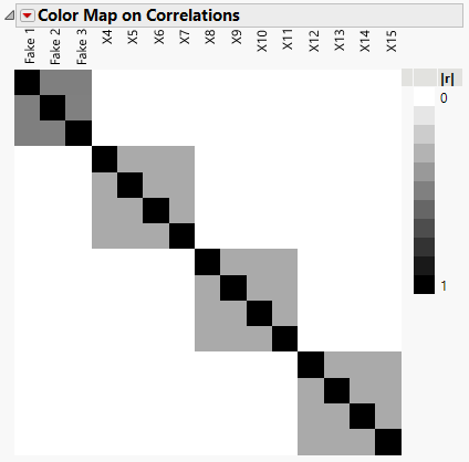

Figure 26.1 GOSSD Color Map on CorrelationsĀ
The structure of the design is evident in the color map. Factors within a group are correlated. Factors in different groups are not correlated, which indicates that they are orthogonal.
