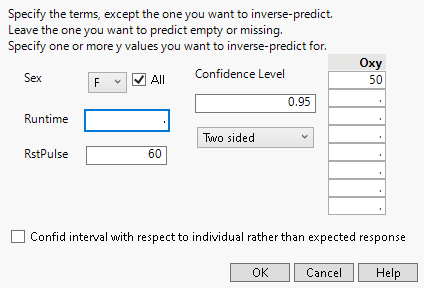

7. Delete the value for Runtime, because you want to predict that value.
8. Select the All box next to Sex to estimate Runtime for all levels of Sex.
9. Replace the mean for RstPulse with 60.
10. Enter the value 50 for Oxy.
Figure 4.53 Inverse Prediction Specification

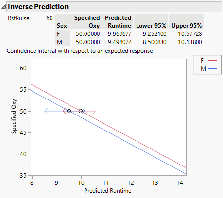

Figure 4.54 Inverse Prediction Report for a Multiple Regression Model
The Inverse Prediction report contains the predicted values of Runtime for both females and males. The plot shows the linear fits for females and males, given that RstPulse is 60. The 95% confidence intervals for females and males are shown in red and blue, respectively.
