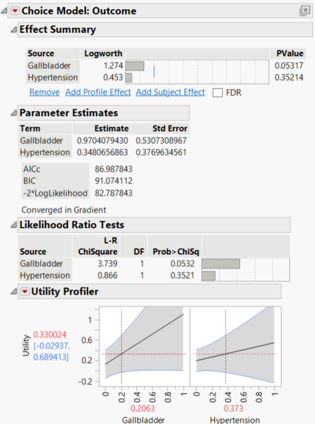

11. Click the Choice Model: Outcome red triangle and select Utility Profiler.
Figure 4.42 Logistic Regression on Endometrial Cancer Data
Likelihood Ratio tests are given for each factor. Note that Gallbladder is nearly significant at the 0.05 level (p-value = 0.0532). Use the Utility Profiler to visualize the impact of the factors on the response.
