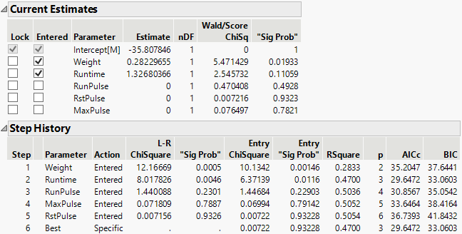

Figure 5.21 Logistic Stepwise ReportĀ
The two variables Weight and Runtime are entered into the model based on the Stopping Rule.

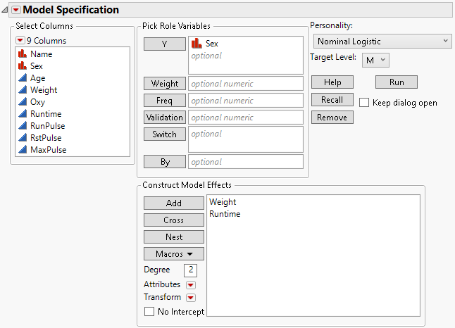

Figure 5.22 Model Specification Window for Reduced ModelĀ
A model specification window appears containing the two variables as model effects. Note that the Personality is Nominal Logistic. If the response had been ordinal, the Personality would be Ordinal Logistic.
