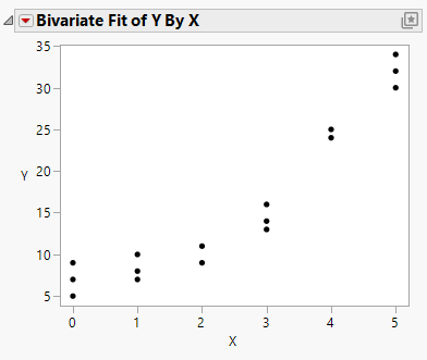

Figure 13.8 Y by X Results
Y by X Results
You can see that Y varies nonlinearly with X and that the variance is approximately constant. Therefore, a normal distribution with a log link function is appropriate to model these data; that is, log(μi) = xi'β so that μi = exp(xi'β).

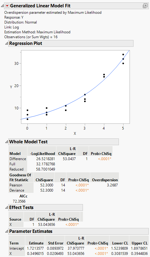

11. Click Run.
Figure 13.9 Model Results
Model Results
