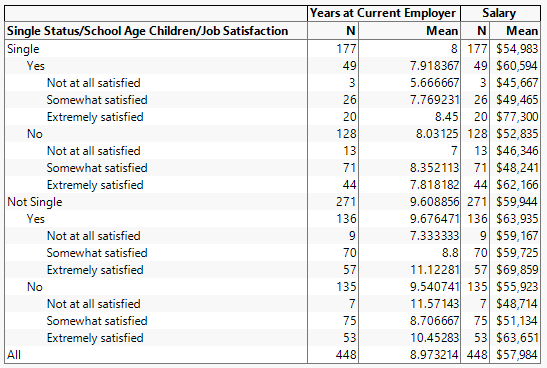

Figure 9.25 Stacked Grouping ColumnsĀ
The table shows a breakdown of mean salary, mean number of years at current employer, and number of respondents for each combination of the grouping variables. For example, there were 20 respondents who were single with school age children and who were extremely satisfied with their job. These 20 respondents have been at their current employer for an average of 8.45 years and have an average salary of $77,300.
The aggregate values for the Single Status and School Age Children variables also appear in the table. For example, not taking job satisfaction into account, there were 128 respondents who were single without school age children. These 128 respondents have been at their current employer for an average of 8.03 years and have an average salary of $52,835.
