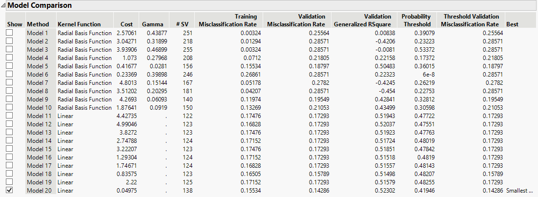

Figure 9.2 Model Comparison Report
The Model Comparison report shows that the best model in terms of misclassification rate and RSquare is Model 20. This model has a linear kernel function with cost parameter 0.04975. This is the model to further analyze.

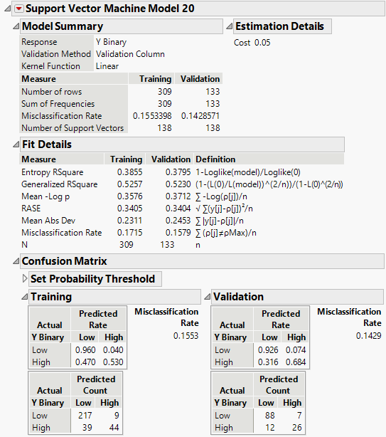

Figure 9.3 Model Report for Best Fitting Model
The Model Summary report shows that the misclassification rates for the training and validation sets are very similar. This is a good indication that the model did not overfit the data. The confusion matrices provide more information about the types of observations that are misclassified by the model. In the confusion matrices, the upper left corner shows that the model correctly categorizes the Low responses most of the time (96% in training and 92.6% in validation). However, fewer of the High responses are correctly categorized (53% in training and 68.4% in validation). Therefore, most of the misclassifications are the High responses being misclassified as Low.
