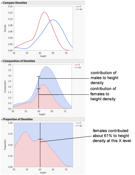

This example illustrates the Densities options in the Oneway platform.
1. Select Help > Sample Data Folder and open Big Class.jmp.
3. Select height and click Y, Response.
4. Select sex and click X, Factor.
5. Click OK.
6. Click the Oneway Analysis red triangle menu and select all three options: Densities > Compare Densities, Densities > Composition of Densities, and Densities > Proportion of Densities.
Figure 6.33 Example of the Densities OptionsĀ
