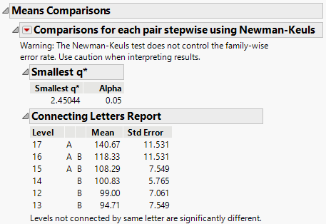

This example uses the Oneway platform to illustrate the Newman-Keuls test.
1. Select Help > Sample Data Folder and open Big Class.jmp.
3. Select weight and click Y, Response.
4. Select age and click X, Factor.
5. Click OK.
6. Click the Oneway Analysis red triangle menu and select Compare Means > Each Pair Stepwise, Newman-Keuls.
Figure 6.20 Example of Means Comparisons Report for Each Pair Stepwise, Newman-Keuls
The Connecting Letters Report shows that Level 17 is significantly different from all other levels except 16 and 15.
