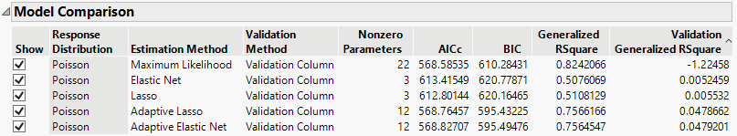

Compare the Models
20. Scroll to the top of the report window.
21. Click the Validation Generalized RSquare column heading in the Model Comparison table.
Figure 7.8 Model Comparison Report
The Model Comparison table is now sorted by the Validation Generalized RSquare values in ascending order. These RSquare values represent how well the models fit the validation set. The negative Validation Generalized RSquare value for the Maximum Likelihood model indicates that this model is over-fitting. The penalized methods all fit the validation data better than the Maximum Likelihood model. None of the penalized models fit the validation data particularly well, but the adaptive methods fit better than the non-adaptive methods. Since the Adaptive Elastic Net model performs best on the validation data, you decide to use it for prediction.

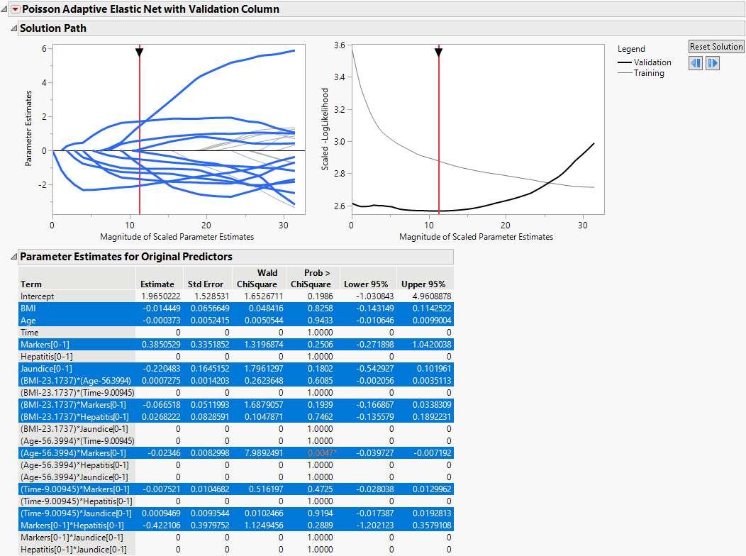

22. Uncheck all the boxes under Show except for the one in the Adaptive Elastic Net row.
23. Click the red triangle next to Poisson Adaptive Elastic Net with Validation Column and select Select Nonzero Terms.
Figure 7.9 Solution Path for Adaptive Elastic Net Fit with Nonzero Terms Highlighted
The nonzero terms in the adaptive elastic net model are selected in the Solution Path and in the Parameter Estimates table.
At this point, you can use this model for prediction or open the Prediction Profiler to further explore the effects of the parameters on the response variable.
