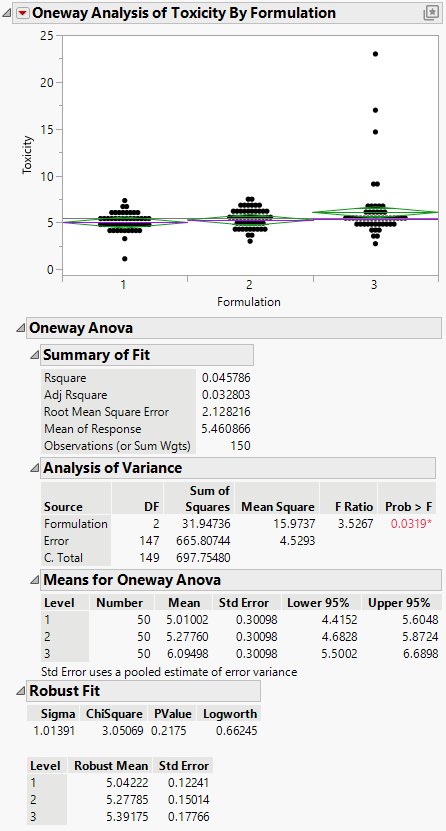

Use the Oneway platform with a robust fit in this example where one of three groups contains outliers. The data contain the toxicity levels for three different formulations of a drug.
1. Select Help > Sample Data Folder and open Drug Toxicity.jmp.
3. Select Toxicity and click Y, Response.
4. Select Formulation and click X, Factor.
5. Click OK.
6. Click the Oneway Analysis red triangle menu and select Means/Anova.
7. Click the Oneway Analysis red triangle menu and select Robust > Robust Fit.
Figure 6.28 Example of Robust FitĀ
