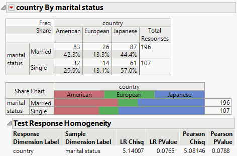

Figure 3.18 Test Response Homogeneity
The Share Chart indicates that the married group is evenly split between ownership of American and Japanese cars. In the single group, Japanese cars are the most frequently owned.
The test for response homogeneity provides results from two versions of the test. The Pearson Test and the Likelihood Ratio Test both have chi-square test statistics and associated p-values. The test for response homogeneity has a p-value of about 0.08 for either method.
