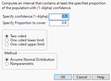

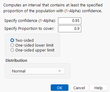

5. Click the OZONE red triangle and select Tolerance Interval.
Figure 3.21 The Tolerance Intervals Window
6. Keep the default selections, and click OK.
