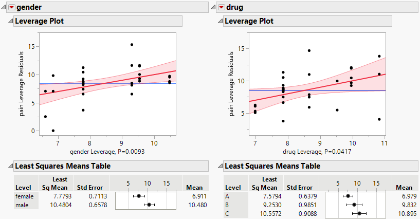

Leverage Plots
Use the leverage plots to identify influential observations and assess their impact on the regression model.
Figure 4.8 Leverage Plot and Least Squares Means Table for Factors
You do not observe any highly influential points. You do observe that both gender and drug have some impact on the response based on the upward trend of the fitted lines and the least squares means values that shift with the levels of gender and drug.

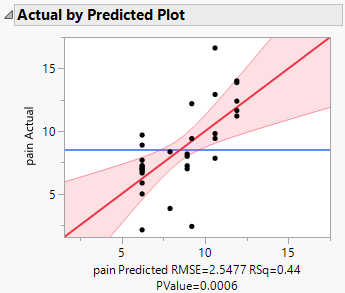

Actual by Predicted Plot
Use the Actual by Predicted Plot to assess the performance and accuracy of the model by comparing the actual values of the pain response with the predicted values from the model.
Figure 4.9 Actual by Predicted Plot
The plot and p-value of 0.0006 indicate that the relationship between the actual and predicted values is statistically significant.

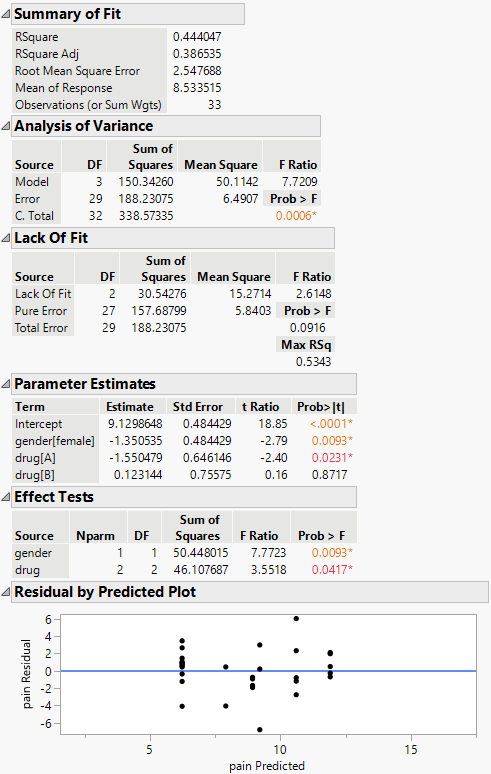

Model Fit Summary Tables and Residual Plot
Use the tables in the report to assess model fit and response variable statistics. The Summary of Fit table contains information to assess model fit and response variable statistics. The Analysis of Variance table contains information about the overall model significance and sources of variation. The Lack of Fit table contains information about model adequacy and error assessment. The Parameter Estimates table contains coefficients, standard errors, and predictor significance. The Effect Tests table contains information about the significance of individual predictors. The Residual by Predicted Plot is to evaluate the assumptions and performance of the regression model by examining the patterns or trends in the residuals across the range of predicted values.
Figure 4.10 Model Summary with ANOVA, Parameters, and Residuals
The tables indicate a regression model with an R-square statistic of 0.444. The effect tests for gender and drug show both factors are statistically significant (with a p-value < 0.05).

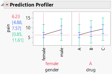

Prediction Profiler
Use the Prediction Profiler to explore how the predicted value of the response varies based on the predictor settings.
Figure 4.11 Prediction Profiler
Prediction Profiler
For females who took type A of the drug, the predicted pain response is 6.23. This predicted response value has a 95% confidence interval of 4.88 to 7.57 and a 95% prediction interval of 0.85 to 11.61. Prediction intervals are for a new observation not used in the construction of the model. Since there is more variability involved in predicting a new observation, prediction intervals are wider than confidence intervals. You can interactively explore the response for various combinations of gender and drug levels in the Prediction Profiler. To visualize how the pain response varies across different combinations of the factor levels, click on the desired level of either gender or drug and then click on the levels of the other factor.
