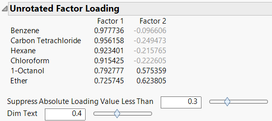

Unrotated Factor Loading
Shows or hides the factor loading matrix prior to rotation. Factor loadings measure the influence of a common factor on a variable. Because the unrotated factors are orthogonal, the factor loading matrix is the matrix of correlations between the variables and the factors. The closer the absolute value of a loading is to 1, the stronger the effect of the factor on the variable.
Use the slider and value to Suppress Absolute Loading Values Less Than the specified value in the table. Suppressed values appear dimmed according to the setting specified by Dim Text.
Use the Dim Text slider and value to control the table’s font transparency gradient for factor values less in absolute value than the specified Suppress Absolute Loading Values Less Than value.
Figure 9.7 Unrotated Factor Loading with Dim Text Controls
Note: The Unrotated Factor Loading matrix is ordered so that variables associated with the same factor appear next to each other.

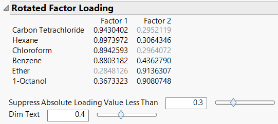

Rotated Factor Loading
Shows or hides the factor loading matrix after rotation. If the rotation is orthogonal, these values are the correlations between the variables and the rotated factors.
Use the Dim Text slider and value to control the table’s font transparency gradient. The lower the value, the more transparency the font for factor values less in absolute value than the specified Suppress Absolute Loading Values Less Than value.
Figure 9.8 Rotated Factor Loading with Dim Text Controls
Note: The Rotated Factor Loading matrix is ordered so that variables associated with the same factor appear next to each other.
