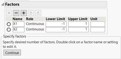

The initial Factors panel for a response surface design appears with two continuous factors.
Figure 12.12 Factors

When you have completed your Factors panel, select Save Factors from the red triangle menu. This saves the factor names and values in a data table that you can later reload. See Response Surface Design Options.
The Factors section contains the following columns:
Name
The name of the factor. When added, a factor is given a default name of X1, X2, and so on. To change this name, double-click it and enter the desired name.
Role
The Design Role is fixed to Continuous for response surface designs. This role is saved to the data table as a column property. This property ensures that the factor is modeled appropriately.
Lower Limit
The lower experimental setting for the factors. To change values, click the default values and enter the desired values.
Upper Limit
The upper experimental setting for the factors. To change values, click the default values and enter the desired values.
Unit
The experimental units for the factors. To specify units for a factor, click and enter the desired values.
