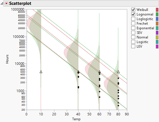

The Fit Life by X platform enables you to analyze lifetime events when only one factor is present. You can choose to model the relationship between the event and the factor using various transformations, or create a custom transformation of your data. You also have the flexibility of comparing different distributions at the same factor level and comparing the same distribution across different factor levels.
Figure 4.1 Scatterplot Showing Varying Distributions and Factor LevelsĀ
