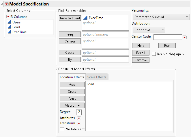

Launch the Fit Parametric Survival platform by selecting Analyze > Reliability and Survival > Fit Parametric Survival.
Figure 15.4 The Fit Parametric Survival Launch Window
Tip: To change the alpha level, click the Model Specification red triangle and select Set Alpha Level.
