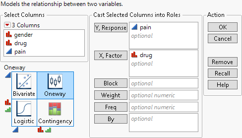

Launch the Oneway platform by selecting Analyze > Fit Y by X. The Fit Y by X launch window is used for four different types of analyses. When you enter a continuous Y variable and a categorical nominal or ordinal X variable, the Oneway platform is launched. A report for each combination of X and Y variables is launched.
Figure 6.4 The Oneway Launch Window

Y, Response
The response variable or variables that you want to analyze. These variables must have a numeric data type.
X, Factor
The predictor variable or variables that you want to analyze. These variables must have a nominal or ordinal data type.
