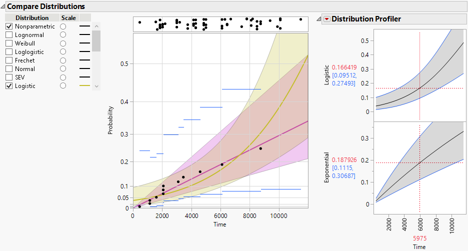

Figure 3.1 Distributional Fits and Comparisons
