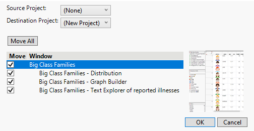

3. From any window, select Window > Move to/from Project.
4. Leave the Source Project as (None) to see files that are not open in any project.
5. Leave the Destination Project as (New Project) to move the selected files into a newly created project.
6. Select the check box next to Big Class Families.jmp. The graphs associated with the data table are also selected.
Figure 11.26 Move Windows To/From Project
7. Click OK. A new project is created with the selected table and reports.
