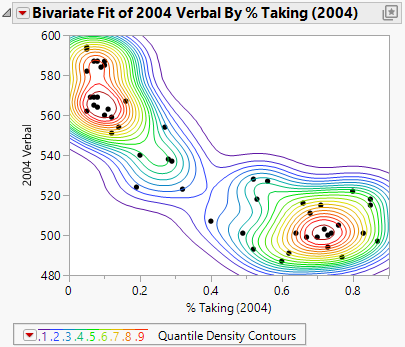

In the Bivariate platform, use the Nonpar Density option to fit a smooth nonparametric bivariate surface to your data. The nonparametric density fit is visualized using a set of contours. The contours are in 5% intervals. This means that about 5% of the points generated from the estimated nonparametric distribution are within the innermost contour, 10% are within the next contour, and so on. The outermost contour contains about 95% of the points.
Figure 5.14 Example of Nonpar Density
To change the size of a nonparametric density contour grid, press Shift and select Nonpar Density from the Bivariate red triangle menu. Enter a larger value than the default 102 points.
For more information about the options in the Quantile Density Contours menu, see Bivariate Fit Options.
Tip: When you have a large number of data points, use the Nonpar Density (nonparametric density) option to view patterns in the scatterplot.
