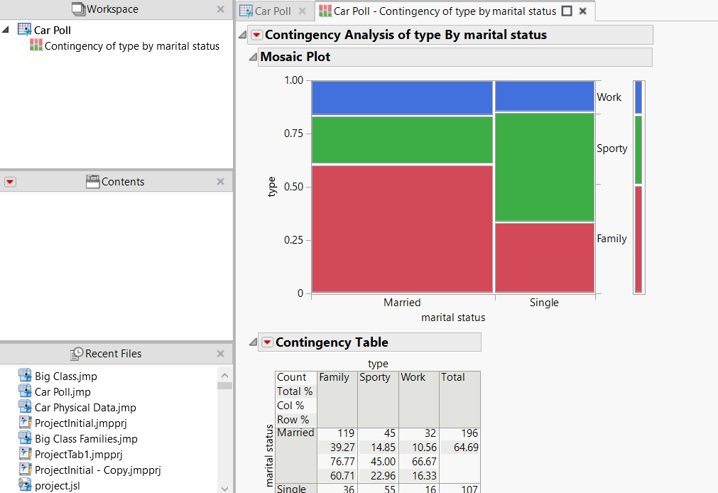

In a JMP project, you can open data tables and then run analyses on the data. Each data table and analysis report opens in a new tab.
1. From a project window, select File > Open and browse to the data tables that you want in the project.
2. From a data table, run an analysis.
If a data table is updated on your computer, any associated reports in your project update when you reopen the project.
