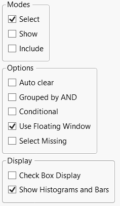

Data Filter preferences customize settings for data filters.
Figure 15.10 Data Filter Preferences
Table 15.9 Preferences on the Data Filter Page
Preference
Description
Modes
Specifies the filtering mode.
Select
Shows the selected rows in the data table in a highlighted state. This option is selected by default.
Show
Shows the unselected rows with the Hide icon. This option is deselected by default.
Include
Shows the unselected rows with the Exclude icon. This option is deselected by default.
Options
Specifies options for the data filter.
Auto clear
If you have more than one nominal or ordinal column selected in the Data Filter, this option clears any other selections before making a new selection. This option is deselected by default.
Grouped by AND
Enables you to control the AND and OR behavior of multiple groups of column filters. This option is deselected by default.
Conditional
Limits the categories displayed for the selected filter column. This option is deselected by default.
Use Floating Window
Keeps the Data Filter window on top of its associated data table. This option is selected by default.
Select Missing
Highlights missing values in the data table. This option is deselected by default.
Display
Specifies display options for categorical columns.
Check Box Display
Shows a check box next to each level. This option is deselected by default.
Show Histograms and Bars
Shows the histogram and bars in the data filter. This option is selected by default.
