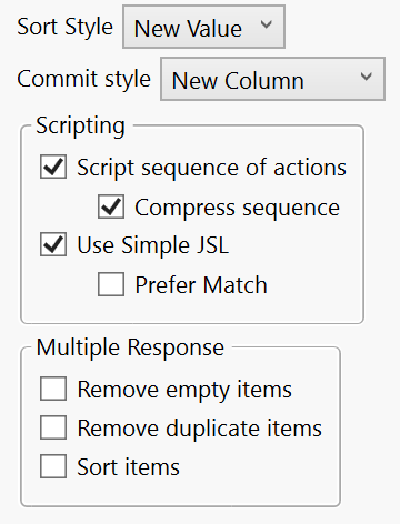

The Recode preferences customize the recoding of columns.
Figure 15.13 Recode Preferences
Recode Preferences
Table 15.12 Preferences on the Recode Page
Preference
Description
Sort style
Specifies how values are sorted by default.
New Value
Sorts in ascending order by the new value.
Old Value
Sorts in ascending order by the old value.
Count
Sorts in descending order with the most common values at the top.
Commit style
Defines the default behavior for recoding columns.
New Column
Puts the values in a new column is the default setting.
Formula Column
Put the values in a formula column. Select this option if you’d like to see how the values are being replaced.
In Place
Replaces the recoded column “in place”.
Script sequence of actions
Saves all of your actions in the script. This option is selected by default. If the option is deselected, only the original and replacement values are included in the script.
Compress sequence
Combines expressions to simplify the saved script. Selected by default when you select Script sequence of actions.
Use Simple JSL
Uses a simple coding style when generating scripts and formulas. This option is selected by default.
Prefer Match
Use the Match() command instead of the Map Value() command when possible. This option is deselected by default.
Remove Empty Items
In a Multiple Response column, excludes empty items in the column when recoding the column in the data table. This option is deselected by default.
Remove Duplicate Items
In a Multiple Response column, excludes duplicate items. For example, if the original data were a, b, b, c, and no changes to those particular items were made, the recoded column in the data table would contain a, b, c. This option is deselected by default.
Sort Items
In a Multiple Response column, sorts items alphabetically. For example, if the original data were b, a, c, and no changes to those particular items were made, the recoded column in the data table would contain a, b, c. This option is deselected by default.
