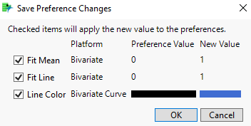

2. On the red triangle menu, select Platform Preferences > Save Changes to. A window similar to the following is displayed:
Figure 9.77 Save Preference ChangesĀ
3. Deselect any options that you do not want to save.
4. Click OK.
