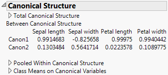

In the Discriminant platform, the Canonical Structure report gives three matrices that provide correlations between the canonical variables and the covariates. Another matrix shows means across the levels of the group variable. To view a matrix, click the disclosure icon beside its names. To hide it, click the name of the matrix.
Figure 5.12 Canonical Structure for Iris.jmp Showing between Canonical Structure
Total Canonical Structure
Correlations between the canonical variables and the covariates. Often called loadings.
Between Canonical Structure
Correlations between the group means on the canonical variables and the group means on the covariates.
Pooled Within Canonical Structure
Partial correlations between the canonical variables and the covariates, adjusted for the group variable.
Class Means on Canonical Variables
Provides means across the levels of the group variable for each canonical variable.
