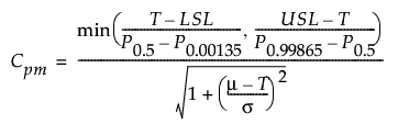

Denote the α*100th percentile of the fitted distribution by Pα. Then Percentile method capability indices are defined as follows:
Equation shown here
Equation shown here
Equation shown here
Equation shown here
Equation shown here
