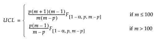

When computing Phase II control limits, new observations are independent of the historical data set. In this case, the upper control limit (UCL) is a function of the F distribution and partially depends on the number of observations in the historical data set from which the targets are calculated. The UCL is defined as follows:
Equation shown here
where:
p = number of variables
m = number of observations in the historical data set
Equation shown here = (1–α)th quantile of an FEquation shown here distribution
