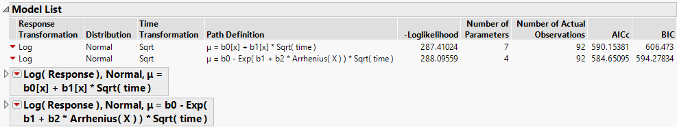

The Destructive Degradation platform report contains a section for each model that you fit. When you fit a model, the Model List is updated with a row for that model.
Note: All models are fit using the maximum likelihood method.

Model List
In the Destructive Degradation platform, the first four columns in the Model List report reflect the choices that you made in the plot options. The -Loglikelihood, AICc, and BIC statistics are information-based measures that can be used for model comparisons. For descriptions of these measures, see Likelihood, AICc, and BIC in Fitting Linear Models.
The three information-based measures in the Model List are comparable across models as long as the models being compared have the same Number of Actual Observations. If this is not the case, exercise caution because different models might use different subsets. The Number of Actual Observations might be reduced due to the choice of distribution or the choice of transformation. Choosing a log-location-scale distribution excludes all nonpositive Y values. Also, the Log and Sqrt transformations exclude all nonpositive values.
