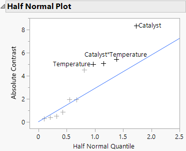

Figure 11.1 Half Normal Plot from Fit Two Level Screening Report
