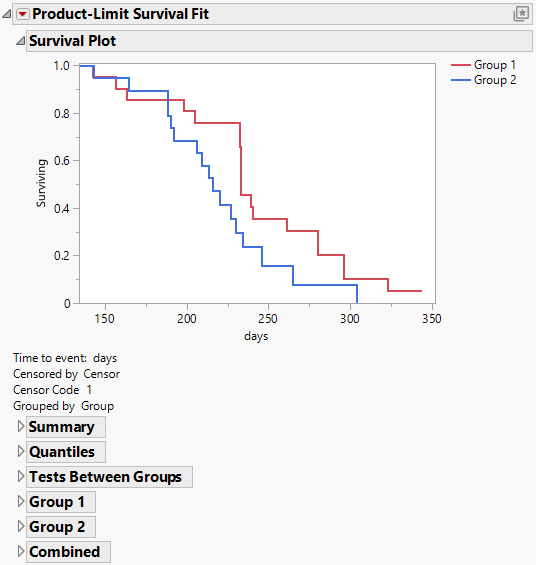

The Survival platform shows overlaid step plots of estimated survival functions for each group. A legend identifies groups by color and line type.
Figure 14.4 The Survival PlotĀ
The Survival Plot
Reports beneath the plot show summary statistics and quantiles for survival times. Estimated survival times for each observation are computed within groups. Survival times are computed from the combined sample. When there is more than one group, statistical tests compare the survival curves.
