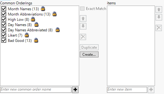

There is a built-in set of orderings (for example, month names, days of the week, and Likert) that automatically sort data. You can make customizations by adding new orderings, modifying previously created orderings, and disabling existing orderings.
Figure 15.14 Value Order Preferences

Exact Match
Specifies whether the items have to be exact matches, including case and whitespace. This option is deselected by default.
Duplicate
Creates a copy of the selected ordering that you can modify.
Create
Select a column from the current table and create an ordering.
