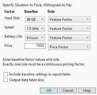

Figure 4.20 Willingness to Pay Specifications
Once you complete your first Willingness to Pay calculation, the platform remembers the baseline values and assigned roles that you selected. This means you can do multiple Willingness to Pay comparisons without having to re-enter the baseline information. If there is no factor called Price, but there is a continuous factor used in the analysis, the continuous factor is automatically assigned as the Price factor in the Willingness to Pay window. Common cost variables that are not prices in the traditional sense include factors such as travel time or distance.

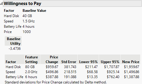

The Willingness to Pay report displays the baseline value for each factor and baseline utility values. For each factor, the report shows the feature setting, estimated price change, and new price. If there are no interaction or second-order effects, standard errors and confidence intervals are also shown. These are calculated using the delta method.
Figure 4.21 Willingness to Pay Report
