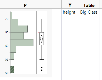

You can add a JMP graph to a new JMP data table. Right-click a graph and select Edit > Make table of graphs like this. The graph and the variables appear in a new data table. You can resize the row and column to enlarge the graph.
Figure 9.46 Histogram and Y Variable Added to Data TableĀ
