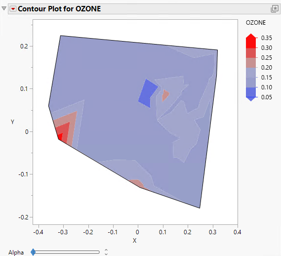

7. Click the Contour Plot for OZONE red triangle and select the following options:
a. Transform > Range Normalized
Instead of Delaunay triangulation, this option changes the method for calculating the triangulations to a normalized scale ([0,1]) in both X and Y.
b. Show Control Panel
The Alpha slider appears.
Figure 10.11 Contour Plot for OZONEĀ

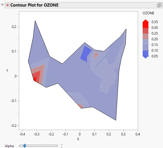

8. Click and move the Alpha slider to the right.
Figure 10.12 Alpha Shapes FilterĀ
Alpha Shapes Filter
Using the Alpha slider filters out the larger Delaunay triangulation areas.
