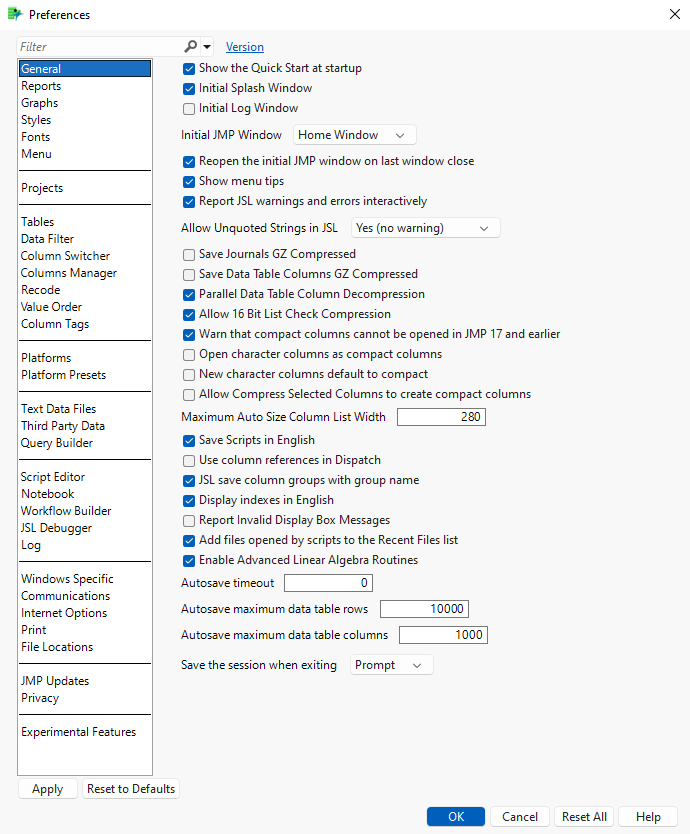

Every JMP platform report window has options that you can turn on or off. However, your changes to these options are not remembered the next time you use the platform. If you want JMP to remember your changes every time you use the platform, change those options in the Preferences window.
To change preferences in JMP, select File > Preferences (Windows) or JMP > Preferences (Apple macOS). You can search for a preference by adding keywords to the Filter box.
Figure 8.6 Preferences Window
Preferences Window
A list of categories appears on the left side of the window. Select a category to see its preferences on the right side of the window.
