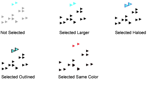

When you select markers on a JMP graph, only the selected markers are highlighted. However, you can change how markers are highlighted on the current graph. The options are applied to the top two triangles in the following figure.
Figure 9.33 Examples of Highlighted Triangular MarkersĀ

Unselected Faded
Only the selected markers are highlighted. Everything else is dimmed by the percent that is specified by Faded amount for unselected markers in Preferences > Graphs.
Selected Larger
The selected markers are larger than the deselected markers.
Selected Haloed
The edges of the selected markers are outlined in blue.
Selected Outlined
The selected markers are outlined in a dark color.
Selected Same Color
The selected markers are shaded with the Marker Selection Color that is selected in the Graphs preferences.
