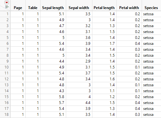

3. In the Table report on the right side of the window, make sure that Concatenate tables with matching column names is selected.
4. At the bottom, click OK.
Figure 3.24 Final Data Table (Partial View)
