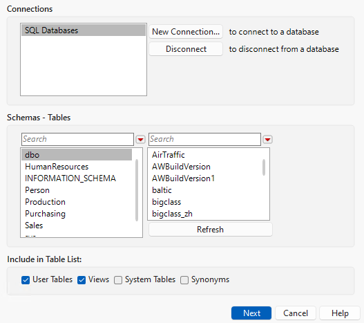

1. Select File > Database > Query Builder to display the Select Database Connection window.
The Connections box lists data sources that you connected to in the current JMP session.
2. If the data source that you want is not listed in the Connections box, click New Connection to choose a data source.
The method of choosing a data source depends on your operating system and the ODBC driver. See Connect to a Database With Open Table.
3. Select a table or schema from the Schemas - Tables box and click Next.
Query Builder examples are based on a table named SQBTest, which contains movie rental data.
Figure 3.35 Select the Database Schema
Tip: To find the table in a long list, enter the name in the search box above the schemas. You can also search for tables in the search box above the list of tables. The red triangle menu provides options for matching case and searching with regular expressions.
