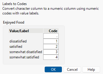

1. Select the character column and select Cols > Utilities > Labels to Codes.
Figure 4.43 Converting Labels to Codes
Default codes are assigned to the values.
2. Change the codes if you want to and click OK.
The column is recoded, and value labels are added to the column.
