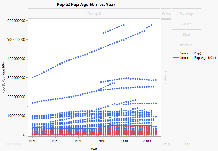

The PopAgeGroup.jmp sample data table contains world region populations by age and year. The Pop column contains country population by year, and the Pop Age 60+ column contains the population aged 60 and older. You want to show these two variables on a single chart.
1. Select Help > Sample Data Folder and open PopAgeGroup.jmp.
3. Select Pop and PopAge 60+ and drag them to the Y zone.
4. Select Year and drag it to the X zone.
Figure 3.14 Pop and Pop Age 60+ Merged
To make the Pop Age 60+ values more visible, calculate yearly means and then add a second Y axis.
