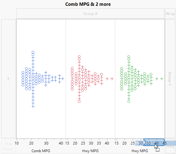

To plot multiple variables in separate axes in the X zone, follow these steps:
1. Select the columns in the Columns list.
2. Press Shift and then click the X zone.
If you want more control over where the variables appear, drag them individually. Drag additional variables above, below, or between existing variables in the X zone.
Figure 3.12 Dragging a Variable to the Right of the Existing Variable
A single polygonal shape indicates when your variable is in the appropriate target zone.

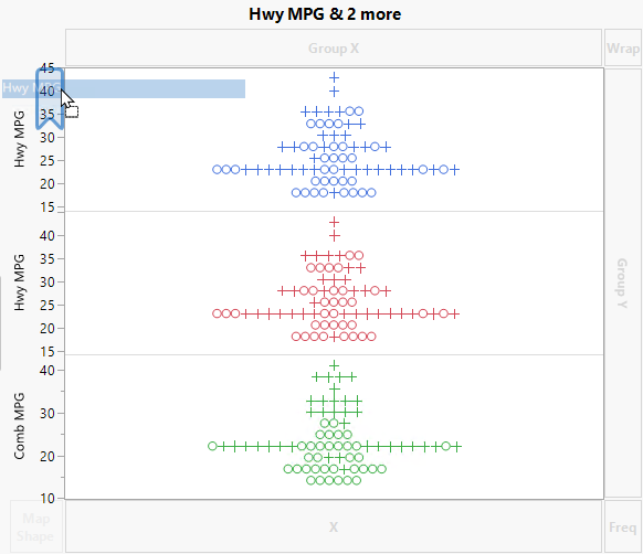

To plot multiple variables in separate axes in the Y zone, follow these steps:
2. Press Shift and then click the Y zone.
If you want more control over where the variables appear, drag them individually. Drag additional variables above, below, or between existing variables in the Y zone.
Figure 3.13 Dragging a Variable above the Existing Variable
