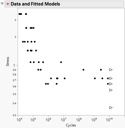

The Data and Fitted Models section of the Fatigue Model report contains a scatterplot of the logarithm of the strain or stress variable (S) versus the logarithm of the lifetime variable (N). Following the convention of plotting S-N data, the scatterplot appears on a log-log scale by default. The initial scatterplot contains only the data points, but models are added to this scatterplot as they are fit. Censored observations are denoted with triangles.
Figure 8.5 Initial Data and Fitted Models ReportĀ
