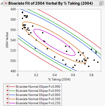

In the Bivariate platform, use the Density Ellipse option to draw an ellipse (or ellipses) that contains the specified mass of points and to estimate and test the correlation between factors. The number of points contained within the ellipse is determined by the probability value that you select from the Density Ellipse menu.
For more information about the options in the Bivariate Normal Ellipse menu, see Bivariate Fit Options. For an example of this option, see Example of Group By Using Density Ellipses.
Figure 5.13 Example of Density Ellipses
The density ellipsoid is computed from the bivariate normal distribution fit to the X and Y variables. The bivariate normal density is a function of the means and standard deviations of the X and Y variables and the correlation between them.
The ellipses show where a given percentage of the data is expected to lie, assuming the bivariate normal distribution. The shape of the density ellipsoid is a graphical indicator of the correlation between two variables. A narrow ellipsoid indicates strong correlation while a more circular ellipsoid indicates less correlation between the two variables.
