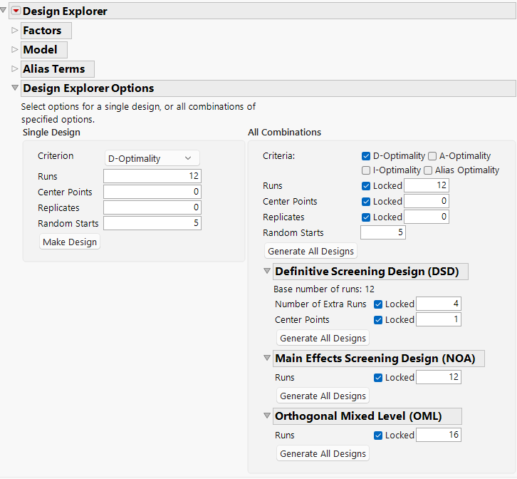

Design Explorer
Use the Design Explorer section to quickly explore how design choices influence the design and to select a set of designs to compare in greater detail. The Design Explorer button opens a new window with the factors, model, and alias terms as specified in the custom design window. There are options to create one design at a time, or to create multiple designs from all combinations of settings. After you create one or more designs, initial design diagnostics are reported in a table. Options allow for further evaluation of individual designs or comparisons across designs.
Figure 4.24 Design Explorer Window
Note: The Design Explorer is available only for designs with any combination of continuous, categorical, or mixture factors.
Design Explorer Options
Use the Single Design section to specify designs one at a time for comparison. Use the All Combinations section to generate a series of designs, including definitive screening designs, for comparison.
Single Design
Set design options for a single design. Click Make Design to add the design to the Results. Specify the optimality criteria, the number of runs, the number of center points, the number of replicates, and the number of random starts used in the design generation algorithm.
All Combinations
Set designs options for a series of designs. Click Generate All Designs to add the designs to the Results. You can specify one or more optimality criteria, the number of runs, the number of center points, the number of replicates (not including the count of center points), and the number of random starts used in the design generation algorithm. To add designs with a range of runs, center points, or replicates, deselect the corresponding Locked check box.
Depending on your design, additional design types are available. These include definitive screen designs, near orthogonal main effects designs, and orthogonal mixed level designs.
Note: Replicate runs are identified by the custom design algorithm in addition to the specified number of Center Points. A replicate run could be an additional center point.
