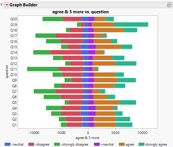

3. Select question and drag it to the Y zone.
4. Select agree, strongly agree, -strongly disagree, -disagree, -neutral, and +neutral and drag them to the X zone.
5. Click the Bar element (Image shown here).
6. In the Bar properties panel, perform the following actions:
– Change the Bar Style to Stacked.
– Open Variables, and then highlight a variable and use the arrow icons to move them into this order, from top to bottom: -neutral, -disagree, -strongly disagree, +neutral, agree, strongly agree.
Figure 4.14 Completed Bar Properties Panel
7. Click the Graph Builder red triangle and select Legend Position > Bottom.
8. Click Done.
Figure 4.15 Graph Prior to Legend Customizations

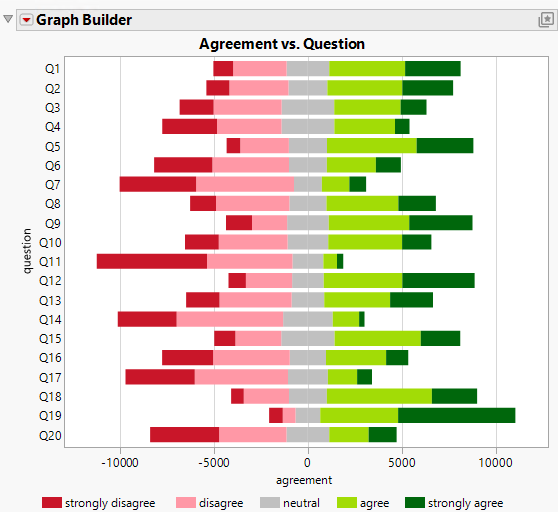

Customize the Legend Colors and Ordering
1. Right-click on each color in the legend and change the Fill Color:
– light gray for +neutral and -neutral
– light pink for -disagree
– red for -strongly disagree
– light green for agree
– dark green for strongly agree
2. Hover over any item in the legend.
The cursor should appear as a hand. Double-click to open the Legend Settings window.
3. Highlight a variable and use the arrow icons to change the order from top to bottom: -strongly disagree, -disagree, -neutral, +neutral, agree, strongly agree.
4. Double-click +neutral and rename it to neutral.
5. Deselect the check box next to -neutral so that it no longer appears in the legend because it is a duplicate.
6. Double-click -strongly disagree and -disagree and remove the - sign.
Figure 4.16 Completed Legend Settings
7. Click OK.
8. Change the titles of the X axis and graph:
a. Click the graph title and enter Agreement vs. Question.
b. Click the X-axis title and enter agreement.
9. Double-click in the Y axis, select the Reverse Order check box, and then click OK.
10. Double-click in the X axis, select the Major Grid Lines check box, and then click OK.
The grid lines help you visually judge the differences between question results.
Figure 4.17 Final Likert Scale Graph
Tip: If an item in the legend is still highlighted, click it to deselect it.
This graph provides a visual summary of 20 survey questions, ignoring the nonresponses. Note that the nonresponses are less than 1% of the total respondents for any question. Therefore, leaving them out of the visualization does not impact the conclusions. Question 19 has the most positive responses, and Question 11 has the least favorable responses.
