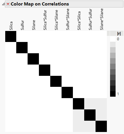

Figure 16.15 Color Map on CorrelationsĀ
The black coloring indicates absolute correlations of one. Note that there are black cells on the diagonal, showing correlations of model terms with themselves. All other cells are either white or gray. The white cells indicate a correlation of zero. The gray cells correspond to correlations between quadratic terms. To see this, hover over each of the gray cell. The absolute correlations of quadratic terms with each other are small, 0.0714.
From the perspective of correlation, this is a good design. When effects are highly correlated, it is more difficult to determine which is responsible for an effect on the response.
