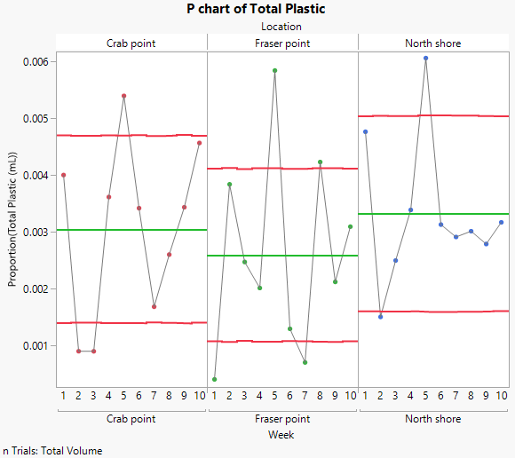

Create a Standard P Chart
1. Select Help > Sample Data Folder and open Quality Control/Water Plastics.jmp.
2. Select Analyze > Quality and Process > Control Chart > P Control Chart.
3. Select Total Plastic and click Y, n Defective.
4. Select Week and click Subgroup.
5. Select Total Volume and click n Trials.
6. Select Location and click Phase.
7. Click OK.
8. Click the Control Chart Builder red triangle and select Sort by Subgroup.
Figure 3.27 Standard P Chart for Water Plastics
There are several points on the standard P chart that are labeled as out of control. Due to how control limits are calculated in the standard P chart, there is a strong possibility that the out of control points are actually false alarms. Compare these results to the results from the Laney P′ chart.

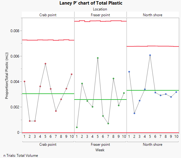

Create Laney P′ Chart
9. Select Analyze > Quality and Process > Control Chart > Laney P′ Control Chart.
10. Select Total Plastic and click Y, n Defective.
11. Select Week and click Subgroup.
12. Select Total Volume and click n Trials.
13. Select Location and click Phase.
14. Click OK.
15. Click the Control Chart Builder red triangle and select Sort by Subgroup.
Figure 3.28 Laney P′ Chart for Water Plastics
Laney P¢ Chart for Water Plastics
Unlike the standard P chart, the Laney P′ chart displays all of the points as in control for this data set.
